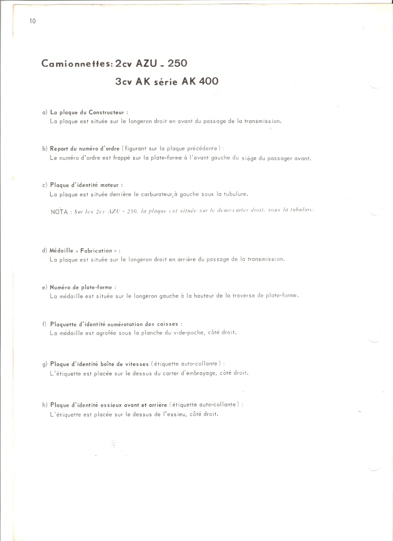

| coup de pouce identification alain | |
